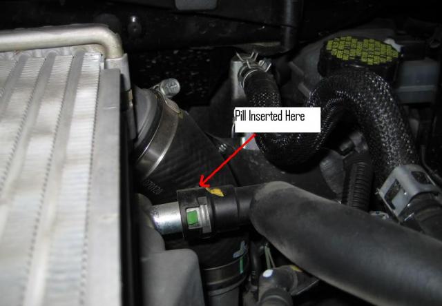

Postby Eclipse » Tue Nov 02, 2010 9:14
but you dont know the truth, so that poses a problem...
Learn why your car smokes first, THEN go talk to Mazda...
Heres a start in the right direction:
http://www.pt-performance.com/showProduct.php?vID=3&cID=4&pID=260

ocd i must say thanks i am going to order the part and try it but is this part somehting that is hard to install on the vehicle?

I have not been in the "scene" for a while, so I do not know the facts about PTP and where they stand currently. Im sure the part can be found somewhere..there were many people buying something at Home Depot or a hardware store that was identical to the piece PTP was selling. All it is is a restrictor. Also, anybody can install this piece in a matter of minutes, even my 8 year old daughter.. movovr has one installed i believe, he may be able to speak up on difficulty

Postby movovr » Wed Nov 03, 2010 9:14
The PTP pcv fix literally takes 5 minutes. You pull the line off the top right side of the crankcase, drop the "pill" in and tap with a mallet so it's snug. Put the line back on and your done.
