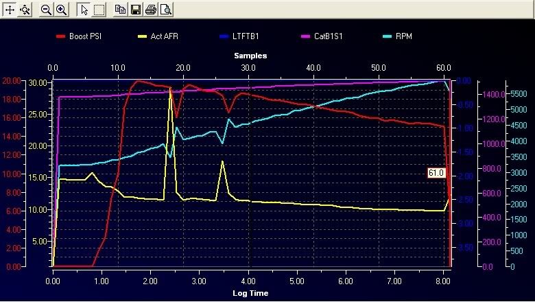

You're logging the wrong AFR (at least in the second one). What you need to log is a mazda specific PID, iirc.

tbot wrote:You're logging the wrong AFR (at least in the second one). What you need to log is a mazda specific PID, iirc.
and I doubt he's running meth, when I was, in this ambient temps, I would see 40 degree BATS
edit...just saw in another thread he's running meth...what were the ambient temps then? I would consistently see below ambient with my setup.
Both AFRs were the wrong one. I changed it in my new logs. AFR at WOT is 11.5 at 3000 rpms tapering to 9.8 at 6000 rpms. I am running a small meth nozzle. I had a 225 ml/min but can't find it. It still drops BATs 20-30 degrees. I do not have one of the intercooler bumper scoops in so its only getting maybe half the airflow as normal which at this ambient temp is not a big deal. FMIC goes on friday, and ill get a new 225 ml/min nozzle.

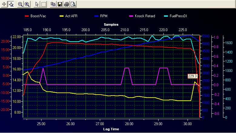

Edit----
Here is a log showing fuel pressure. Had some .4 knock.
