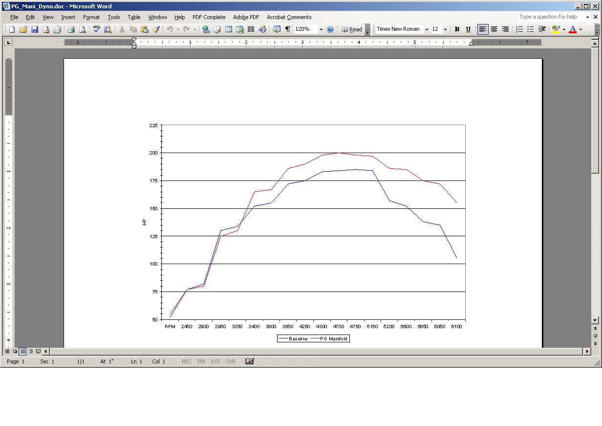

I have created my own comparison between my baseline dyno prior to the new PG manifold and my post PG Manifold dyno. Unfortunately I could not do a direct comparison because the run files for my baseline were overwritten by accident.
These numbers are UNCORRECTED. I made four runs and each run gained anywhere from 3-5 hp. Apparently my car gains hp the hotter the engine gets, meaning the stock manifold was really restricting airflow at higher temps. Enjoy.
Dyno results
Dyno results
I agree, but I am much more exciteed about the end of that curve. Things are much more exciting now above 5000 rpms. I used to treat that area as no man's land, but I find myself taking her to near redline much more often now.
