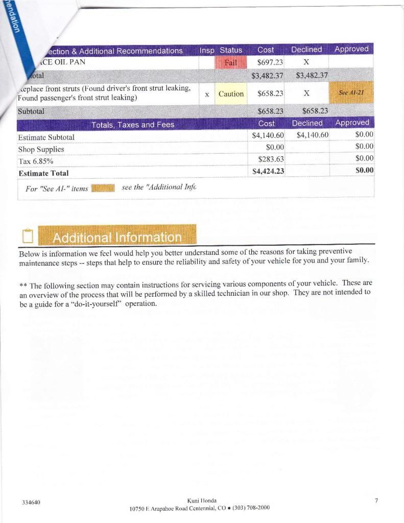

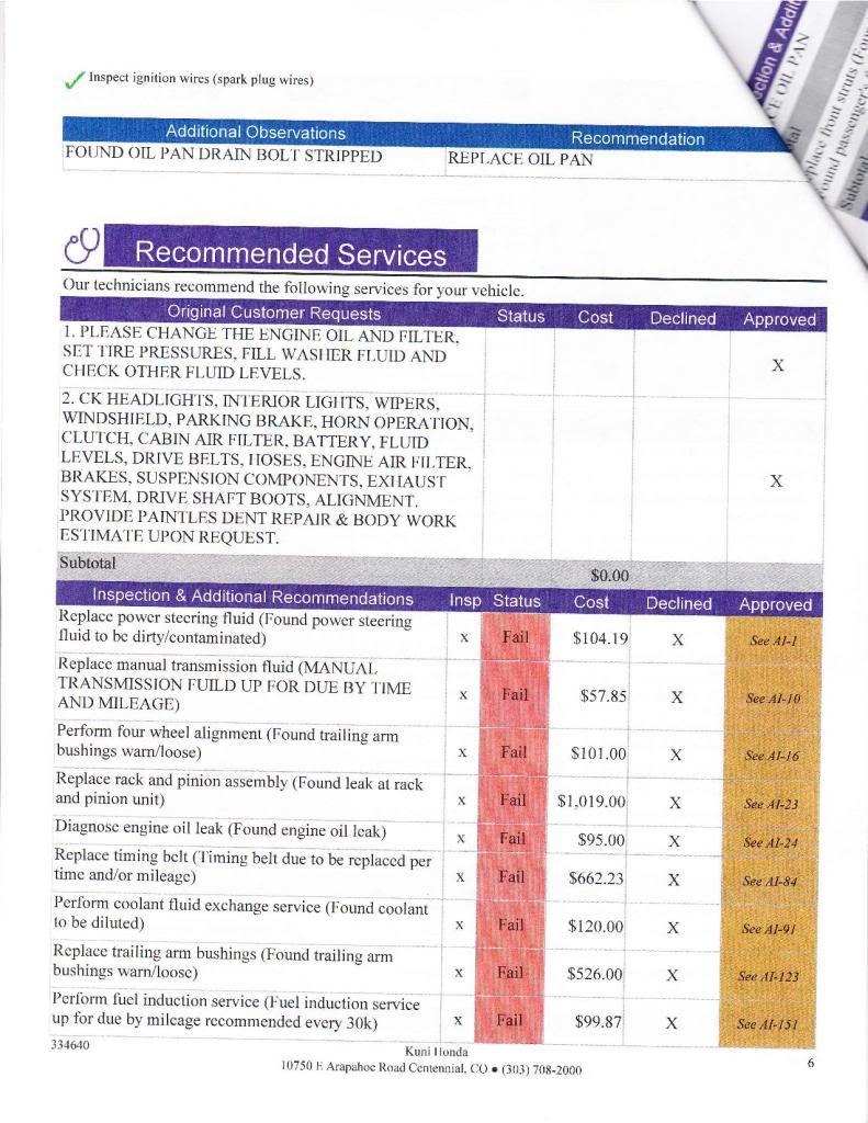

Hello there, I brought my 1998 Honda Civic HX to Kuni Honda on Arapahoe Rd. to have them change the oil yesterday and after about half an hour of waiting, they came out and told me that my oil pan drain plug has been stripped so for now, they put some Hondabond blue for a temporary fix and I'm leaking a bit of oil from my drain plug. Maybe 3-4 drops every 20 min. I drove to Boulder today and I was low about half a quart so I just bought 3 quarts of 5w-30 synthetic to keep it filled. Kuni wants $700 to replace the oil pan and gasket which I think it's very unreasonable. I had Grease Monkey in Boulder on 28th street replace my oil last and I know they were probably the ones who over torqued the drain bolt. They also gave me a list of other things that are wrong with my car which adds up to $4,400 which is absurd!! I have attached the list they gave me. If someone could explain to me what those things should really cost and what shop to go to that uses good quality parts or allow me to give them the part to use to replace, that would be great!! Thank you very much!!

I'm not sure why he originally made an account here, but sean is one of my friends. I think he mostly wants some advice on a good, trustworthy shop in town somewhere to do some of the things that Kuni noted as failing their inspection since dealerships charge outrageous amounts of money. For example, they want like $700 to replace the oil pan, $300 of which is for the part alone, but the part can be found online for under $200, and that leaves a good 400-500 on top of a $200 part.

Your 98 Civic HX has a D16Y5 engine, I'm pretty sure the oil pan is directly interchangeable with other D16 engines, so there are literally tons of local salvage sources for this, maybe $50 for a oil pan pull. Alternately, I see them being sold new for $186 (http://www.hondapartsunlimited.com/honda/pan-oil/11200-p2j-000-honda/). If you go the route of a new or used replacement pan, you'll want a new oil pan gasket and a gasket sealer of course. To drop the oil pan, you must first drain the engine oil, drop an engine-to-tranny stiffener brace, and then the pan should unbolt and drop out.
I have a spare d16Y7 oil pan sitting around, I guess I'd be willing to sell it for $50, but you might want to look around more, the Y7 has a steel oil pan (Y8 has aluminium, Y5 has ____? -- all are supposedly interchangeable, but there may be an alternate stiffener for the steel one.)
A cursory search of Honda forums suggests you should be able to track down a generic self-tapping oversized oil drain plug for just this situation, though I have no personal experience with that, others weld new bungs or even claim they've used a helicoil, so there are alternatives to replacing it at all.

According to some threads on Honda-Tech, my Y5 has an aluminum pan same as the EX with the Y8. I'll be expecting a call from Grease Monkey today so I hope they can tell me that I could go in there and get a new, free oil pan from them because after all, it is their fault they over torqued it. I just hope if they do replace it that they use Honda Genuine parts... It's just getting really frustrating to open my hood, check my oil level and fill it up with oil every time I need to go somewhere. I just don't want my engine seized because it was low on oil. I have 148,500 miles on it now and it feels like I can go another 148,500 miles!

As for my oil leak, I talked to grease monkey today and they were explaining to me how Kuni Honda has voided the tamper seal and that Grease Monkey cannot prove if it's their fault or Kuni's fault. So I think I'm just going to go ahead and get a new oil pan since I can't wait any longer because my oil leak has gotten to the point where I need to pull over on I-25 in traffic to check my oil and it always seems a bit low.

For the oil pan. Just replace it. Hit up junk yards and search 96-00 honda civics (not ex-si) they all have d16y7.
Not trying to be a douche but if you search oil pan replacement on honda forums you wiil find every thing you need in minutes.

Soooo I called a few places today and only one of them called Auto Know How gave me a reasonable price to do a time sert on it. So they want $150 to do it and I'm providing the oil and I insist they don't replace my oil filter because it's only a week old. Their price to replace the oil pan was over $500 so they must be paying full price for the OEM part.
