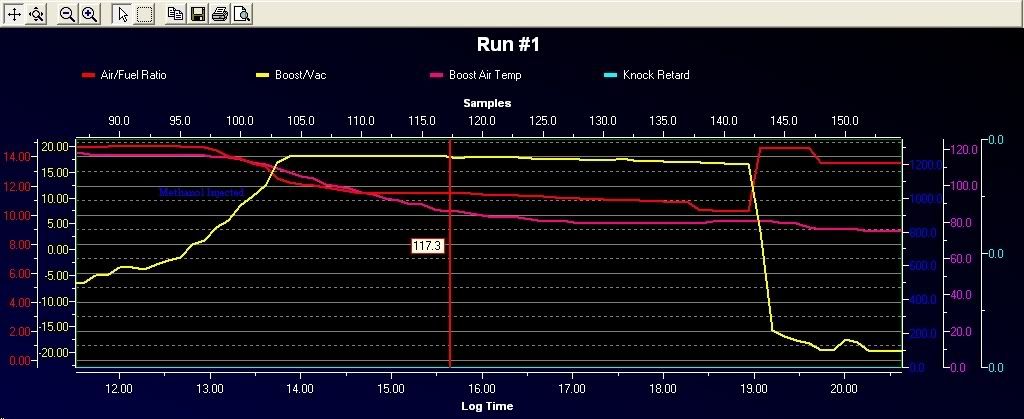

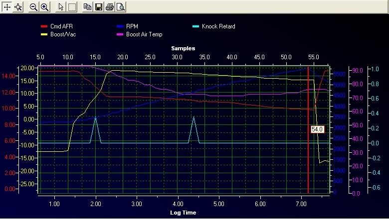

I logged a few 4th gear pulls after I upped the boost to see how the hypertech would handle it. Did get some small .3-.4 knock on the second run but the AFR looked good. The tune holds boost decently past 5000 rpm. Let off on the second run at 5800 rpms. Held 15.3 psi there and 9.8 afr. Much better than stock because it holds the throttle open at the end. 1st run does not have rpm.
