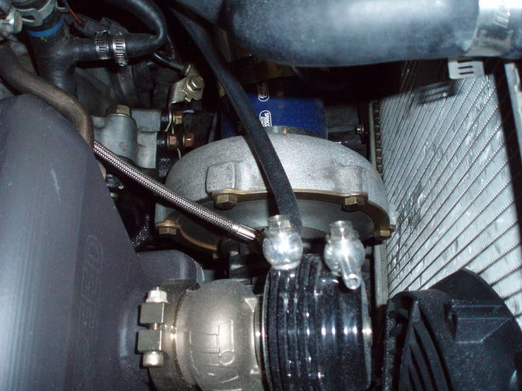

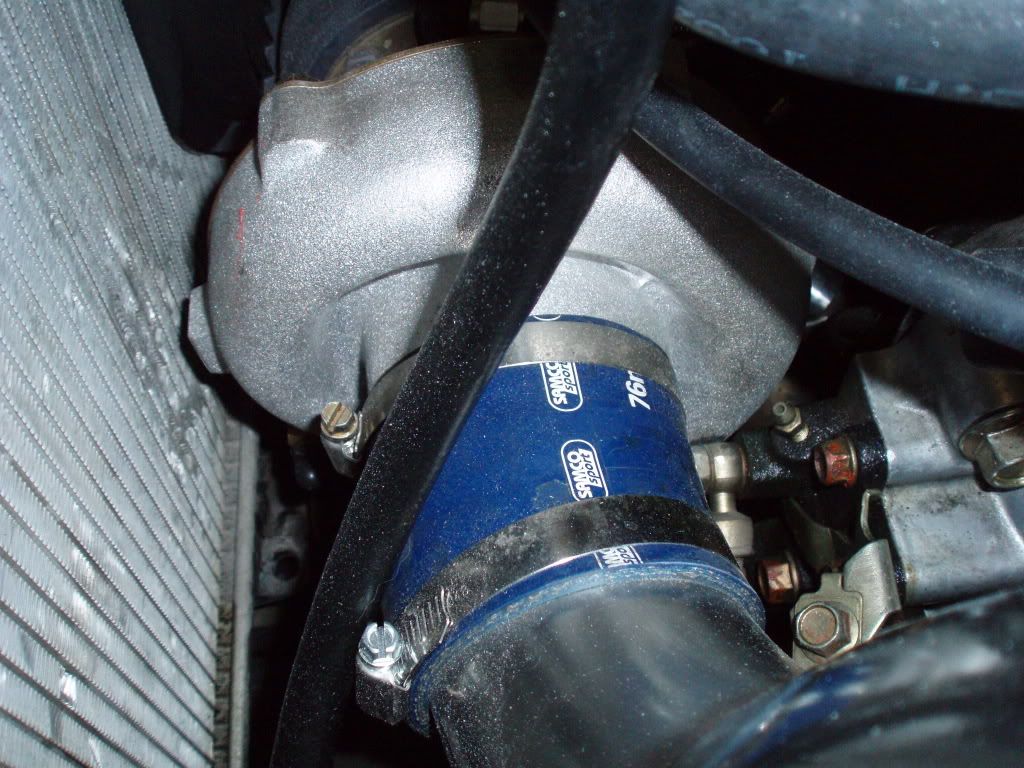

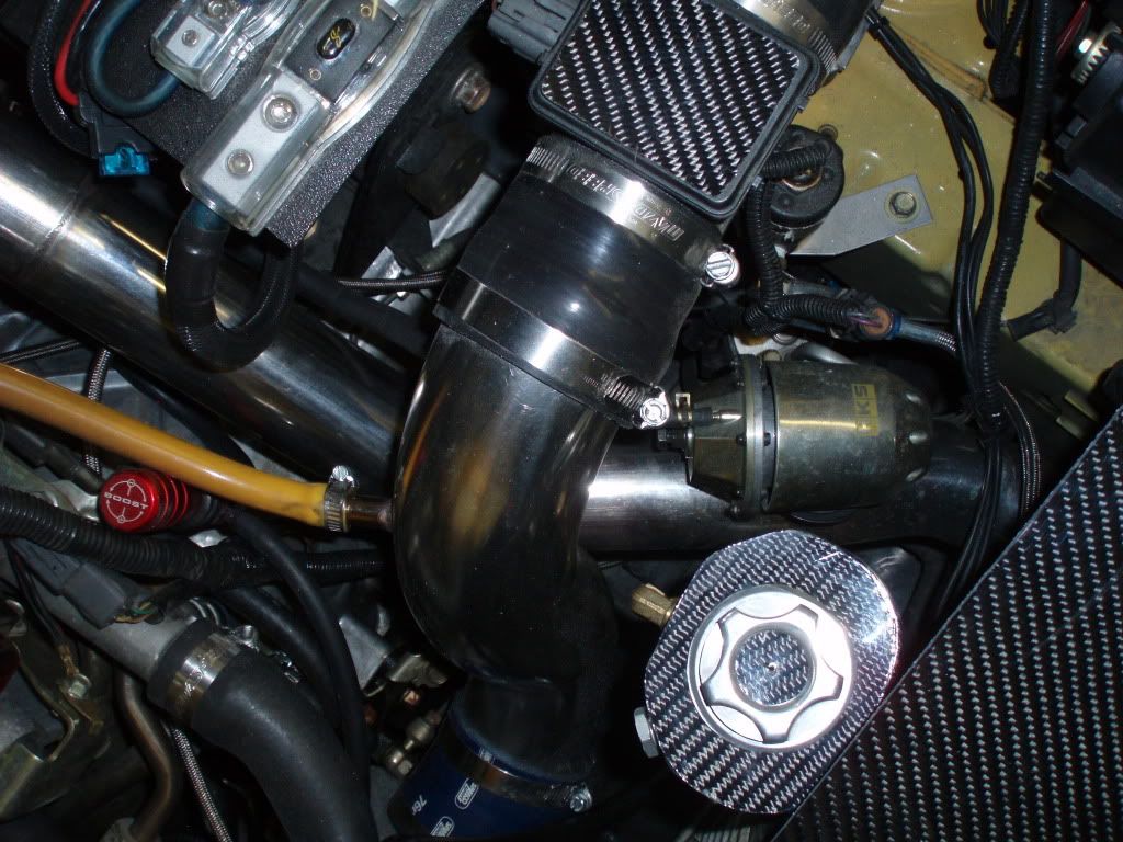

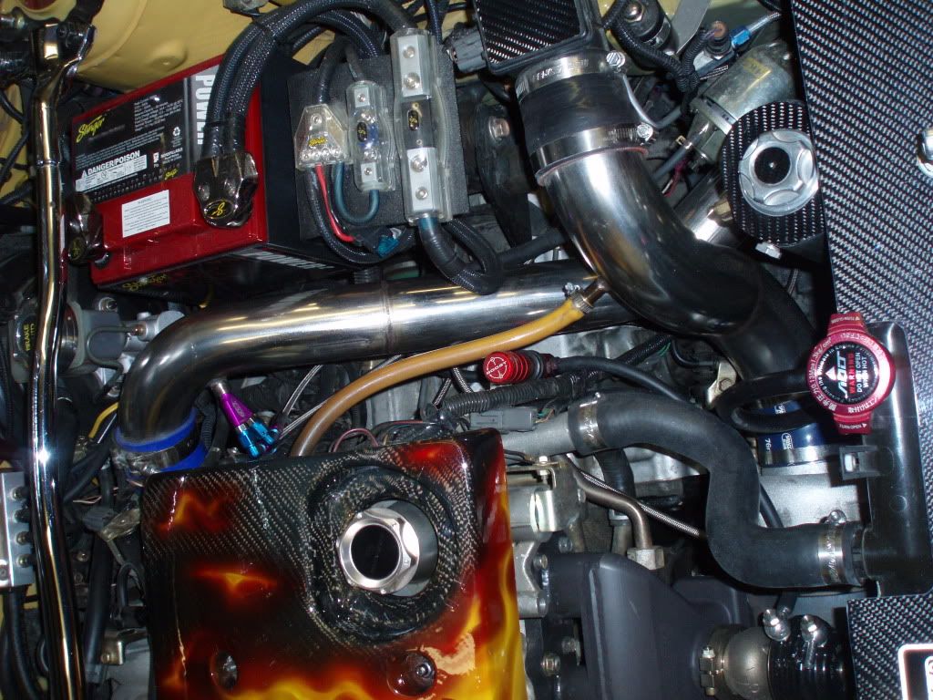

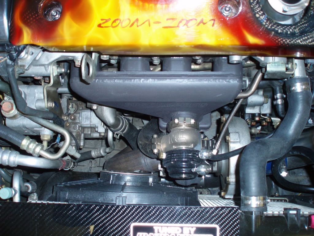

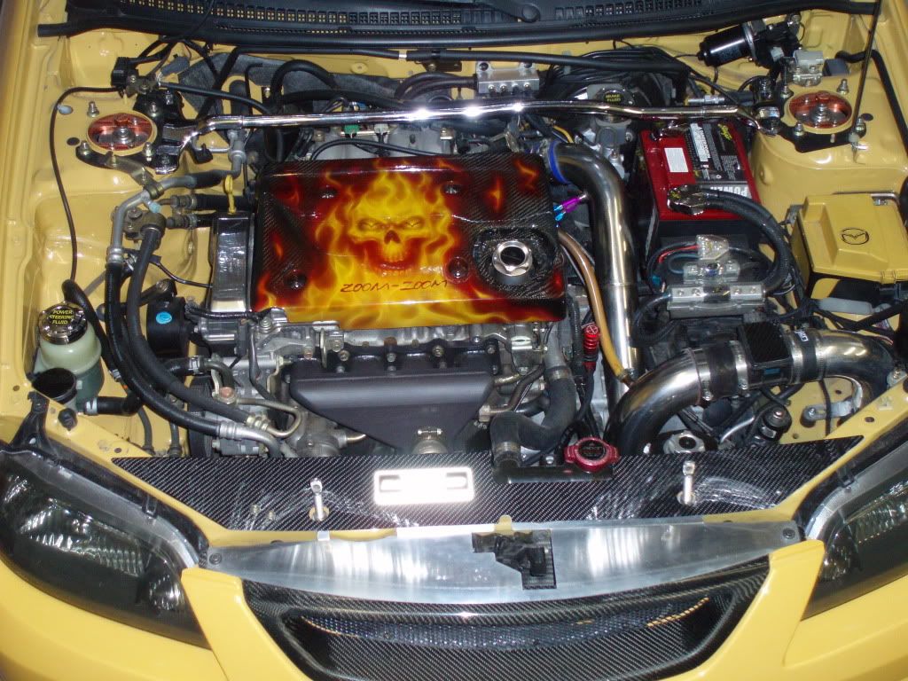

So this project was more complicated than invisioned. I started big but had to scale back. I didn't have enough room between the block and radiator. Tommy (Street Concepts) and I tried everything rerouting the cooling system, smaller radiators etc. In the end I switched out the custom exhaust manifold and downpipe with cut-off for a Steedspeed Mani and custom downpipe and dump pipe.
Currently break-in the turbo build with 13lbs boost at 300hp. The plan is to bring it back down to Street Concepts later this Spring to check everything out and tighten everything up before taking it back to MAC and turning up the boost and increasing horsepower. Next will be rehooking-up the Zex wet system.
Here is a picture of the engine bay after mods
Pictures of Turbo - Close Tolorances
Steedspeed Exhaust Mani & TiAl External Wastegate with Dump Pipe
Turbolife FMIC with Nitrous Express Spray Ring
Custom Intercooler Pipes and relocated HKS BOV
